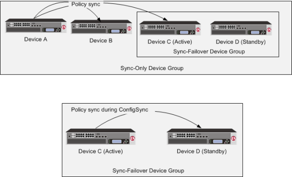

To synchronize access policies between multiple devices, you configure a Sync-Only device group that includes the devices between which you want to synchronize access policies.
Note: To add devices to a device group, the devices must all belong to the same trust domain.
For policy sync to work seamlessly, the Sync-Only device group configuration must specify an automatic type of sync. However, the process to perform a policy sync remains manual. The process involves selecting an access policy, running a sync, and resolving conflicts as needed.

Access policy synchronization in Sync-Only and Sync-Failover device groups
