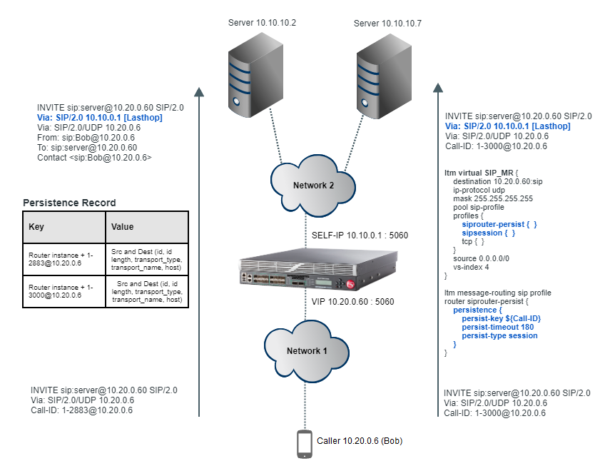

This diagram shows a call from Call-ID 1-2883 @10.20.0.2 being load balanced to Server 10.10.10.2. And it also shows a call from 1-3000@10.20.0.6 being load balanced to 10.10.10.7, and the persist records created from these calls when persistence is enabled with a key of Call-ID.
Basic load balancing with session persistence example
