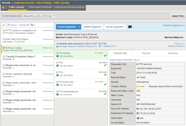

This figure shows the Traffic Learning screen with several suggestions on it. As an example, on the left, the suggestion to enforce a cookie is highlighted; the information on the right shows what caused the suggestion. The HTTP violations are listed, and one is selected showing details about the request. The cookie PHPAUCTION_SESSION matched the * wildcard in the Allowed Cookies list in several requests so the suggestion is to add and enforce the cookie. If you accept the suggestion, the cookie is added to the Enforced Cookies list.
Traffic Learning screen with suggestions

  4. Review the learning suggestions as follows.
    1. Select a learning suggestion.
      Information is displayed about the action the system will take if you accept the suggestion, and what caused the suggestion.
    2. Select a suggestion to learn more about what caused it by looking at the action, the number of samples it is based on, the violations caused and their violation ratings, and if available, by examining samples of the requests that caused the suggestion.
    3. Select a request to view data about the request on the right, including any violations it generated, the contents of the request itself, and the response (if any).
      By examining the requests that caused a suggestion, you can determine whether it should be accepted.
    4. To add comments about the suggestion and the cause, click the Add Comment icon
      to the right of the suggestion commands, and type the comments.
  5. Decide how to respond to the suggestion. You can start with the suggestions that have the highest learning scores, or those which you know to be valid for the application. These are the options.

Note: This task is primarily for building a security policy using manual learning. If you are using the automatic learning mode, the system cab automatically enforce entities in the security policy, if you selected the Learning Mode Auto-apply Policy, when it has processed sufficient traffic and sessions over enough time, from different IP addresses, to determine the legitimacy of the file types, URLs, parameters, cookies, methods, and so on. .
  1. On the Main tab, click Security > Application Security > Policy Building > Traffic Learning.
    The Enforcement Readiness summary is on the bottom right.
  2. In the Current edited security policy list near the top of the screen, verify that the security policy shown is the one you want to work on.
  3. Below the charts on the right, review the Enforcement Readiness Summary to see if there are entities that are ready to be enforced. If there are, select the entities you want the security policy to enforce, and click Enforce Ready Entities.
    If you select this option, you are done with this task. Continue only if you want to enforce selected entities or signatures instead of enforcing all entities ready to be enforced.
  4. In the Enforcement Readiness Summary, check to see if a number appears in the Not Enforced column.
    A number greater than zero indicates that entities of that type are in staging, or have wildcard entities configured so that the security policy learns all explicit entities that match them.
  5. Click the number in the Not Enforced column.
    The allowed file types, URLs, parameters, cookies, signatures, or redirection protection list opens showing the entities that you can enforce.
  6. Select the entities you want the security policy to enforce, and click Enforce.
The system removes the selected entities or signatures from staging, and enforces them in the security policy. If any of the entities are wildcards that are learning explicit entities, the system deletes the wildcards.
