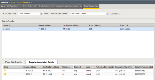

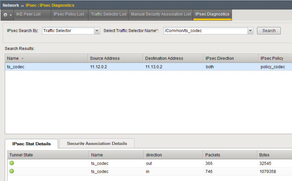

- The IPsec Stat Details tab includes the tunnel state, direction, number of packets, and total bytes.
- The Security Association Details tab includes the state of the association, source and destination IP addresses, direction, IPsec protocol, authentication algorithm, encryption algorithm, and SPI.
These examples show the diagnostic details that are available as the result of an IPsec traffic selector search.
The color of the icon in the Tunnel State or security association (SA) State column indicates the condition of the connection.
- Green indicates that the tunnel is up and running.
- Blue indicates that the SA is in the negotiating phase, before the tunnel is up.
- Yellow indicates that the SA is still valid, but will be deleted soon.
- Red indicates that the tunnel is down.
