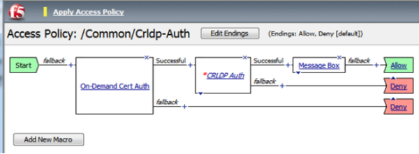

This is an example of an access policy with all the associated elements needed to retrieve CRLs using CRLDP. Notice that you must add either the Client Cert Inspection agent or On-Demand Cert Auth agent before the CRLDP object in your access policy. One of those agents is required in order to receive the X.509 certificate from the user. This is also important because both agents store the user information, as well as the issuer certificates, in the session variables. This allows the CRDLP Auth agent to check the revocation status of the user’s certificate.
When the CRLDP Auth access policy item runs, it populates session variables which are then available for use in access policy rules. The table lists the session variables for the CRLDP access policy item and for the certificate item used in the access policy.

You add CRLDP authentication to an access policy when you want to verify certificate revocation status before granting a user access.
On the Main tab, click Access > Profiles / Policies > Access Profiles (Per-Session Policies).
The Access Profiles (Per-Session Policies) screen displays.
In the Per-Session Policy column, click the Edit link for the access profile you want to configure.
The visual policy editor opens the access policy in a separate screen.
Click the (+) icon anywhere in the access policy to add a new item.
Note: Only an applicable subset of access policy items is available for selection in the visual policy editor for any access profile type.
A popup screen opens, listing predefined actions on tabs such as General Purpose, Authentication, and so on.
From the Authentication tab, select either Client Cert Inspection or On-Demand Cert Auth, and click Add item.
Client Cert Inspection checks the result of an SSL handshake request that occurs at the start of an SSL session. On Demand Cert Auth performs an SSL re-handshake and checks the result. The CRLDP and OCSP Auth actions require certificate information made available by one of these policy items.
Click Save.
The popup screen closes.
On the Authentication tab, select CRLDP Auth, then click Add item.
A properties popup screen opens.
From the CRLDP Server list, select a server.
Click Save.
To grant access at the end of any branch, change the ending from Deny to Allow:
Click Deny.
The default branch ending is Deny.
A popup screen opens.
Select Allow and click Save.
The popup screen closes. The Allow ending displays on the branch.
Click Apply Access Policy to save your configuration.
The access policy is complete.

- Select ignore if the On-Demand Cert Auth agent is used.
From the Trusted Certificate Authorities list, select the Certificate Authority that issues the user certificates.
From the Advertised Certificate Authorities list, select the Certificate Authority that issues the user certificates.
Click Finished.
A new client SSL profile is available.
Note: CRLDP authentication does not verify a certificate revocation list if one is selected in the client SSL profile. CRLDP authentication verifies the certificate revocation list (CRL) at a distribution point defined in the CRLDP AAA server.
You associate the client SSL and access profiles with the virtual server so that the BIG-IP system handles client-side SSL traffic as specified, and so that Access Policy Managercan apply the access profile to incoming traffic.
On the Main tab, click Local Traffic > Virtual Servers.
The Virtual Server List screen opens.
Click the name of the virtual server you want to modify.
For the SSL Profile (Client) setting, from the Available list, select the name of the Client SSL profile you previously created and move the name to the Selected list.
In the Access Policy area, from the Access Profile list, select the access profile that you configured earlier.
Click Update to save the changes.
The access policy and client-side SSL profiles are now associated with the virtual server.
