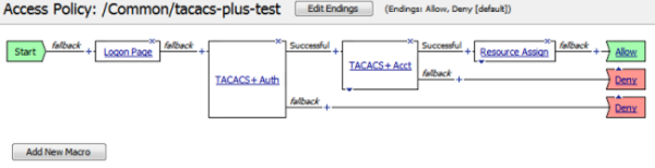

This is an example of an access policy with all the associated elements needed to authenticate and authorize users with TACACS+ authentication. Note that the server used for authentication can be different from the server used for TACACS+ accounting service.
