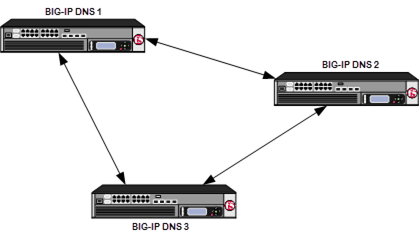

You can configure BIG-IP DNS (formerly (GTM)) systems in collections called BIG-IP DNS synchronization groups. All BIG-IP DNS systems in the same BIG-IP DNS synchronization group have the same rank, exchange heartbeat messages, and share probing responsibility.
Configuration changes to one device in a BIG-IP DNS synchronization group are synchronized incrementally across the devices in the group. That is, only the data that has changed on a BIG-IP DNS device is synchronized to the other devices in the group. Although incremental synchronization is the default behavior, if an incremental synchronization fails, the system automatically performs a full configuration synchronization.
BIG-IP DNS systems in a BIG-IP DNS synchronization group
When you add a BIG-IP DNS system to a network that contains older BIG-IP DNS systems, the devices can exchange heartbeat messages, even though the BIG-IP software versions are different. However, to add BIG-IP DNS to a configuration synchronization group, you must run the gtm_add script.
