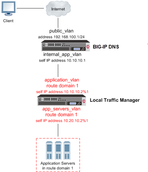

Configuring BIG-IP DNS on a Network with One Route Domain
You can deploy BIG-IP DNS on a network where BIG-IP Local Traffic Manager (LTM) is configured with one route domain and no overlapping IP addresses.
CAUTION:
For BIG-IP systems that include both LTM and BIG-IP DNS, you can configure route domains on internal interfaces only. F5 Networks does not support the configuration of route domains on a standalone BIG-IP DNS.
BIG-IP DNS deployed on a network in front of a BIG-IP LTM configured with a route domain
