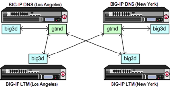

The gtmd agent on BIG-IP DNS uses the iQuery protocol to communicate with the local big3d agent, and the big3d agents installed on other BIG-IP systems. The gtmd agent monitors both the availability of the BIG-IP systems, and the integrity of the network paths between the systems that host a domain and the local DNS servers that attempt to connect to that domain.
Communications between big3d and gtmd agents using iQuery
