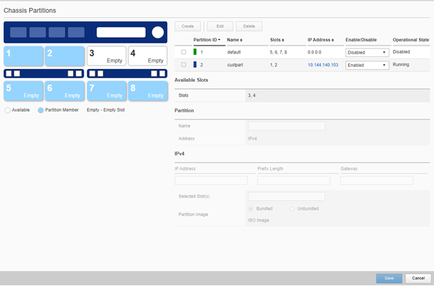

You can view details on how the chassis partitions are configured on your VELOS system from the system controller webUI.
  1. Log in to the VELOS system controller webUI using an account with admin access.
  2. On the left, click CHASSIS PARTITIONS.
    The Chassis Partitions screen opens.
  3. Review the chassis partition data:
    • Examine the graphic to see how many slots are in use. Those in use are highlighted.
    • Review the chassis partition list to see how many chassis partitions currently exist, which slots are associated with each partition, the management IP address of each, whether the chassis partition is Enabled or Disabled, and the operational status.
  4. Perform other tasks as needed regarding chassis partition management:
    • From here, you can create, edit, or delete chassis partitions.
    • You can Enable or Disable a chassis partition using the Enable/Disable partition list.
Here is a sample Chassis Partitions screen with two chassis partitions: one named custpart, which uses the two slots that contain blades, and the other, default, which is assigned four empty slots. The custpart partition is Enabled and running. Additional information may also be available on this screen.

After you have created a chassis partition, you can enable it and log in to it using the default admin username and password.

Before you can use a chassis partition, you must add slots to the chassis partition. Slots can be assigned to one partition only.
  1. Log in to the command line interface (CLI) of the system controller using an account with admin access.
    When you log in to the system, you are in user (operational) mode.
  2. Show how chassis partitions and slots are currently configured on the system.
    show running-config slots
    A summary similar to this example, which shows that all slots are still assigned to the default chassis partition, displays:
    syscon-1-active# show running-config slots
    slots slot 1
     partition default
    slots slot 2
     partition default
    slots slot 3
     partition default
    slots slot 4
     partition default
    slots slot 5
     partition default
    slots slot 6
     partition default
    slots slot 7
     partition default
    slots slot 8
     partition default
  3. Change to config mode.
    config
    The CLI prompt changes to include (config).
  4. Add the slot to a specified chassis partition.
    slots slot [ default | <*slot-number*> | none ] partition <*partition-name*>
    This example adds slot 1 to a chassis partition named custompartition:
    syscon-1-active# slots slot 1 partition custompartition
  5. Repeat to add slots to other chassis partitions.
  6. Commit the configuration changes.
    commit
  7. Return to user (operational) mode.
    end
  8. Confirm that the chassis partitions and slots are correctly configured on the system.
    A summary similar to this example displays:
    slots slot 1
    slots slot 2
     partition default
    slots slot 3
     partition default
    slots slot 4
     partition default
    slots slot 5
     partition default
    slots slot 6
     partition default
    slots slot 7
     partition default
    slots slot 8
     partition default
After adding slots to chassis partitions, the blade reboots to install the appropriate chassis partition software.
