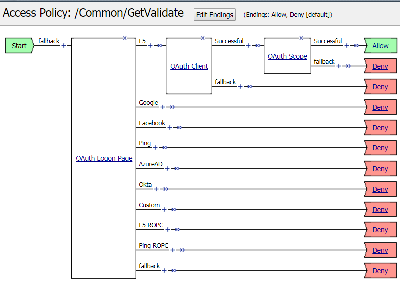

When configured as an OAuth client, Access Policy Manager (APM®) supports authorization code and resource owner password credentials grant types.
To configure Access Policy Manager (APM®) as an OAuth client and resource server, first you must create these objects: OAuth providers, OAuth servers, and OAuth requests. Then, you must configure APM policies with agents that reference the objects to get tokens, get permission for scopes, and retrieve scopes.
An OAuth provider configuration object specifies an external OAuth authorization server type and settings to support opaque access tokens, JSON web tokens, and ID Tokens and OpenID Connect UserInfo requests for those providers that support OpenID Connect.
An OAuth server specifies an OAuth provider and the OAuth role that Access Policy Manager (APM®) plays with that provider. It also specifies the IDs, secrets, and SSL certificates that APM requires to communicate with the OAuth provider.

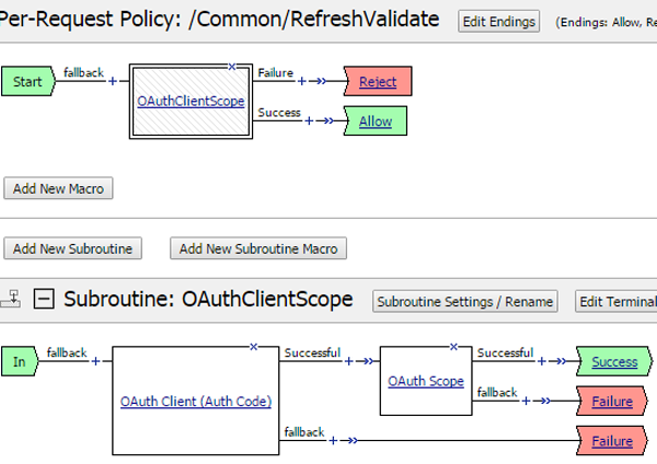

In Access Policy Manager (APM®), the request object enables configuration of requests to meet the requirements of your OAuth providers. The object supports requests for scope permission, scope data, authorization redirect, tokens, and OpenID Connect UserInfo. It specifies the HTTP method, parameters, and headers to use for the specific type of request.
An OAuth Client agent is a policy item that requests authorization and tokens from an OAuth server. An OAuth Client can also get scope data on a per-request basis. The OAuth Client agent provides these configuration elements and options:

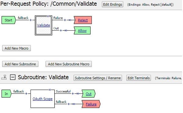

The OAuth Scope agent validates JSON web tokens (JWT) or validates scopes for opaque tokens. The OAuth Scope item provides these elements and options:
- Token Validation Mode
- Internal - In this mode, the agent validates JSON web tokens (JWT).
- External - In this mode, the agent makes requests to an OAuth authorization server to get scopes associated with a token and to get scope data, such as a user’s email address or contact list.
- JWT Provider List
- Specifies a list of OAuth providers that support JWT. The agent validates JWT from any of these providers when configured. Displays when Token Validation Mode is set to Internal.
Note: Provider lists are configured in the Access > Federation > JSON Web Token > Provider List area of the product.

To obtain an access token one time only for the session, you need to configure an access policy. The OAuth Client agent can request a token.
With this access policy, the user logs on through a BIG-IP system. The OAuth Client agent obtains an access token, and an OAuth Scope agent tries to retrieve the list of scopes associated with the token from the OAuth provider. The session starts. When the token expires, the system makes no attempt to refresh it.
To obtain an access token and to validate it for each request, first you need an access policy to obtain the token.
To periodically validate and refresh the token, you need a per-request policy subroutine.
When Access Policy Manager (APM) acts as an OAuth resource server, an OAuth Scope agent validates tokens obtained from the incoming request.

A per-request policy runs at each request. A per-request policy subroutine runs periodically at whichever of these intervals is shorter: the number of minutes specified in the OAuth server Token Validation Interval field on Access Policy Manager (APM®), or the interval that the external OAuth authentication server specifies in the expires_in attribute of the access token it issues.
Before you start, you need an OAuth server configured in Access Policy Manager (APM) that supports clients (Mode is set to Client or Client + Resource Server) .
You configure a per-request policy subroutine to periodically validate an OAuth token, to obtain a new or a refresh token, to get scopes and scope data.
On the Main tab, click Access > Profiles / Policies > Per-Request Policies.
The Per-Request Policies screen opens.
In the Name field, locate the policy that you want to update, then in the Per-Request Policy field, click the Edit link.
The visual policy editor opens in another tab.
Click the Add New Subroutine button.
A popup screen opens.
On the Select Subroutine template list, retain the selection Empty, and click Save.
The popup screen closes. The subroutine, with the heading [+] Subroutine: Name, displays below the main editor.
Expand the subroutine by clicking the [+] icon.
The subroutine displays.
Click the (+) icon anywhere in the subroutine to add a new item.
A small set of actions are provided for building a subroutine.
A popup screen displays actions on tabs, such as General Purpose and Authentication, and provides a search field.
On the Authentication tab, select OAuth Client.
Click Add Item.
The screen is not active while the visual policy editor creates the action. The screen closes and a Properties screen opens.
In the Name field, type a name for the policy item.
This name is displayed in the action field for the policy.
From the Server list, select an OAuth server.
Only OAuth servers configured with Mode set to Client or Client + Resource Server display.
From the Grant Type list, select one of these:
Authorization code - Redirects the user to the external server to authenticate. The user is redirected back to APM with an authorization code. APM uses the authorization code to request an access token
Password - Requests an access token from the external server by using the user’s credentials (username and password). If this method is configured, the user must provide their external credentials to APM; to make this happen, you must insert a logon page before the OAuth Client item in the access or the per-request policy.

Add the subroutine to the per-request policy:
On a per-request policy branch, click the (+) icon.
Select the Subroutines tab.
Select the subroutine and click Add Item.
The popup screen closes and the policy displays.
To rename the subroutine or to update number of seconds that the subroutine has to complete its interactions with the OAuth server, perform these steps:
Click Subroutine Settings/Rename.
To rename the subroutine, type in the Name field.
To update the timeout, type a number in the Subroutine Timeout (sec) field.
Important: No additional settings on this screen are applicable to the OAuth Client and OAuth Scope items.
Click Save.
The popup screen closes. The subroutine displays in the policy.
Click Save.

You can add, delete, and reorder the list of OAuth providers that display on an OAuth Logon Page.
Open the per-session policy (or the per-request policy subroutine) that you want to update.
Click the OAuth Logon Page item.
A Properties screen opens.
In row 1 of the Logon Page Agent table, click the Values field.
Row 1 contains values for the oauthprovidertype variable.
A popup screen displays options with a Value and a Text field for each provider.
Add, delete, or reorder the providers, and click Finished.
The popup screen closes. The updated list of providers displays in the Values field in row 1.
If you added a provider, add a branch rule for that provider:
Click the Branch Rules tab.
Click Add Branch Rule.
A new entry with Name and Expression settings displays.
In the Name field, replace the default name by typing a new name.
The name appears on the branch in the policy.
Select and copy an expression from another branch rule.
For example, copy the expression displayed for the F5 branch rule:
`expr` {[`mcget` {**session.logon.last.oauthprovidertype**}] == "`F5`"} -
For the branch rule that you added, in the Expression setting click the change link.
Click the Advanced tab, paste the expression into the field, and replace the existing provider name (such as
F5) with the new provider name.For example, the result might look like this:
`expr` {[`mcget` {**session.logon.last.oauthprovidertype**}] == "`Siterequest`"} -
Click Finished.
Click Save.
The properties screen closes and the policy displays.
Click Finished.

To configure an OAuth Scope agent to validate opaque tokens or to get UserInfo or both, perform these substeps:
From Token Validation Scope, select External.
On the Authentication tab, select OAuth Scope.
From the Server list, select an OAuth server that you know to be configured with Mode set to Resource Server.
Important: Do not select an OAuth server configured with Mode set to Client + Resource Server.
From the Scopes Request list, select a request.
Only validate-scopes-request type requests display.
If F5 (APM) is the OAuth provider, select F5ScopesRequest.
To add scope data requests, click Add new entry and, in the Scope Name field, type the name of a scope that the OAuth provider supports; then, from the Request list, select a scope data request that was configured to meet the requirements of the OAuth provider.
Click Save.
The properties screen closes. The policy displays.
To save and apply any changes that you made to the access policy, click Apply Access Policy.
To add an OAuth Scope agent to a per-request policy subroutine:
To open a per-request policy for editing, click the Edit link in thePer-Request Policy field.
Note: If you must create a per-request policy first, provide a name for it that is unique among all access profiles and per-request policies.
Click Add New Subroutine.
A popup screen opens. The Subroutine from template field specifies Empty.
Click Save.
The popup screen closes. The heading, [+] Subroutine: Name, displays below the main editor.
Expand the subroutine for editing by clicking the [+] icon.
In the subroutine area, click [+].
An Add Item popup screen opens.
On the Authentication tab, select OAuth Scope and click Add Item.
To configure the OAuth Scope agent properties, follow the instructions provided in this task previously.
To add the subroutine to the per-request policy, in the main editor click the [+] icon.
Click the Subroutines tab, select the subroutine, and click Add Item.
The subroutine displays in the per-request policy.
