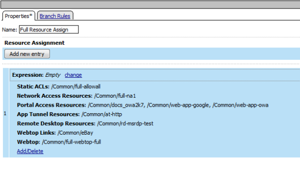

Resource assign action with resources and a webtop assigned
A webtop allows your users to connect and disconnect from the network access connection.
