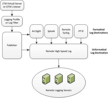

You can configure the BIG-IP system to log information about Access Policy Manager® (APM® ) and Secure Web Gateway events and send the log messages to remote high-speed log servers.
When configuring remote high-speed logging of events, it is helpful to understand the objects you need to create and why, as described here:
Note: Enabling remote high-speed logging impacts BIG-IP system performance.
Object Reason
Pool of remote log servers Create a pool of remote log servers to which the BIG-IP system can send log messages.
Destination (unformatted) Create a log destination of Remote High-Speed Log type that specifies a pool of remote log servers.
Destination (formatted) If your remote log servers are the ArcSight, Splunk, or Remote Syslog type, create an additional log destination to format the logs in the required format and forward the logs to a remote high-speed log destination.
Publisher Create a log publisher to send logs to a set of specified log destinations.
Log Setting Add event logging for the APM system and configure log levels for it or add logging for URL filter events, or both. Settings include the specification of up to two log publishers: one for access system logging and one for URL request logging.
Access profile Add log settings to the access profile. The log settings for the access profile control logging for the traffic that comes through the virtual server to which the access profile is assigned.

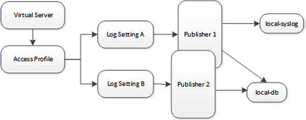

Association of remote high-speed logging configuration objects

Before creating a remote high-speed log destination, ensure that at least one pool of remote log servers exists on the BIG-IP system.
Create a log destination of the Remote High-Speed Log type to specify that log messages are sent to a pool of remote log servers.
  1. On the Main tab, click System > Logs > Configuration > Log Destinations.
    The Log Destinations screen opens.
  2. Click Create.
  3. In the Name field, type a unique, identifiable name for this destination.
  4. From the Type list, select Remote High-Speed Log.
    Important: If you use log servers such as Remote Syslog, Splunk, or ArcSight, which require data be sent to the servers in a specific format, you must create an additional log destination of the required type, and associate it with a log destination of the Remote High-Speed Log type. With this configuration, the BIG-IP system can send data to the servers in the required format.
    The BIG-IP system is configured to send an unformatted string of text to the log servers.
  5. From the Pool Name list, select the pool of remote log servers to which you want the BIG-IP system to send log messages.
  6. From the Protocol list, select the protocol used by the high-speed logging pool members.
  7. Click Finished.

Create a formatted logging destination to specify that log messages are sent to a pool of remote log servers, such as Remote Syslog, Splunk, or IPFIX servers.
  2. Click Create.
  4. From the Type list, select a formatted logging destination, such as Remote Syslog, Splunk, or IPFIX.
    The Splunk format is a predefined format of key value pairs.
    The BIG-IP system is configured to send a formatted string of text to the log servers.
  5. If you selected Remote Syslog, then from the Syslog Format list select a format for the logs, and then from the High-Speed Log Destination list, select the destination that points to a pool of remote Syslog servers to which you want the BIG-IP system to send log messages.
    Important: For logs coming from Access Policy Manager (APM), only the BSD Syslog format is supported.
  6. If you selected Splunk or IPFIX, then from the Forward To list, select the destination that points to a pool of high-speed log servers to which you want the BIG-IP system to send log messages.
  7. Click Finished.

Ensure that at least one destination associated with a pool of remote log servers exists on the BIG-IP system.
Create a publisher to specify where the BIG-IP system sends log messages for specific resources.
  1. On the Main tab, click System > Logs > Configuration > Log Publishers.
    The Log Publishers screen opens.
  2. Click Create.
  3. In the Name field, type a unique, identifiable name for this publisher.
  4. For the Destinations setting, select a destination from the Available list, and click << to move the destination to the Selected list.
    Note: If you are using a formatted destination, select the destination that matches your log servers, such as Remote Syslog, Splunk, or ArcSight.
  5. Click Finished.
Create log settings to enable event logging for access system events or URL filtering events or both. Log settings specify how to process event logs for the traffic that passes through a virtual server with a particular access profile.
  1. On the Main tab, click Access > Overview > Event Logs > Settings.
    A log settings table screen opens.
  2. Select a log setting and click Edit or click Create for a new APM log setting.
    A popup screen opens with General Information selected in the left pane.
  3. For a new log setting, in the Name field, type a name.
  4. To specify logging, select one or both of these check box options:
    • Enable access system logs - This setting is generally applicable. It applies to access policies, per-request policies, Secure Web Gateway processes, and so on. When you select this check box, Access System Logs becomes available in the left pane.
    • Enable URL request logs - This setting is applicable for logging URL requests when you have set up a BIG-IP system configuration to categorize and filter URLs. When you select this check box, URL Request Logs becomes available in the left pane. Important: When you clear either of these check boxes and save your change, you are not only disabling that type of logging, but any changes you made to the settings are also removed.
  5. To configure settings for access system logging, select Access System Logs from the left pane.
    Access System Logs settings display in the right panel.
  6. For access system logging, from the Log Publisher list select the log publisher of your choice.
    A log publisher specifies one or more logging destinations.
    Important: The BIG-IP system is not a logging server and has limited capacity for storing, archiving, and analyzing logs. For this reason a dedicated logging server is recommended.
  7. For access system logging, retain the default minimum log level, Notice, for each option.
    You can change the minimum log level, but Notice is recommended.

  3. To assign this log setting to multiple access profiles now, perform these substeps:
    Note: Up to three log settings for access system logs can be assigned to an access profile. If you assign multiple log settings to an access profile, and this results in duplicate log destinations, logs are also duplicated.
    1. Select Access Profiles from the left pane.
    2. Move access profiles between the Available and the Selected lists.
    Note: You can delete (and add) log settings for an access profile on the Logs page for the access profile.
    Note: You can configure the log destinations for a log publisher from the Logs page in the System area of the product.
  4. Click OK.

Event log duplication
The figure illustrates a configuration that writes duplicate logs. Two log publishers specify the same log destination, local-db. Each log publisher is specified in one of the log settings that are assigned to an access profile. Logs are written to the local-db destination twice.
Duplicate log messages are written when the same log destination is specified by two or more log publishers and more than one of the log publishers is specified in the log settings that are assigned to an access profile.
One way to avoid or eliminate this problem is to specify only one log setting for each access profile. Another is to ensure that the log publishers you associate with log settings for an access profile do not contain duplicate log destinations.
