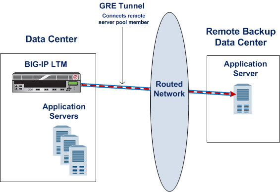

Point-to-point IP encapsulation tunnels carry traffic through a routed network between known devices. For example, you can create a GRE tunnel to connect a BIG-IP® system to a remotely located pool member.
Illustration of a point-to-point GRE tunnel
  1. Creating a point-to-point IP tunnel
  2. Assigning a self IP address to an IP tunnel endpoint
  3. Routing traffic through an IP tunnel interface
To create a point-to-point tunnel, you specify the encapsulation protocol and the IP addresses of the devices at both ends of the tunnel.
  1. On the Main tab, click Network > Tunnels > Tunnel List > Create or Carrier Grade NAT > Tunnels > Create.
    The New Tunnel screen opens.
  2. In the Name field, type a unique name for the tunnel.
  3. From the Profile list, select the type that corresponds to the encapsulation protocol you want to use.
    The selection ipip is the same as ip4ip4, but ipip is compatible with configurations from an earlier release.
  4. In the Local Address field, type the IP address of the BIG-IP system.
  5. From the Remote Address list, select Specify, and type the IP address of the device at the other end of the tunnel.
  6. Click Finished.
After you complete this task, traffic is encapsulated using the protocol you specified between the BIG-IP system and the remote device you specified.

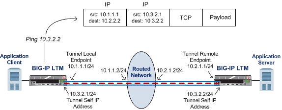

The BIG-IPsystem requires that tunnels used as routes have a self IP address associated with the tunnel itself, distinct from the self IP address configured as a tunnel endpoint. After configuring a self IP address, you can configure routes that use the tunnel as a resource.
Ensure that you have created an IP tunnel before starting this task.
Self IP addresses can enable the BIG-IP system, and other devices on the network, to route application traffic through the associated tunnel, similar to routing through VLANs and VLAN groups.
Note: If the other side of the tunnel needs to be reachable, make sure the self IP addresses that you assign to both sides of the tunnel are in the same subnet.

This illustration is an example of a point-to-point IP tunnel configuration showing IP addresses. Note that the tunnel local endpoint address is different from the tunnel self IP address.
Illustration of a point-to-point IP tunnel configuration

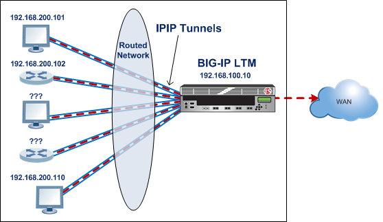

In a network that has multiple devices connected to a BIG-IP® system, you can create an IPIP or GRE encapsulation tunnel between the BIG-IP system and the remote devices without having to specify a remote (or source) IP address for every device. The use cases include situations where the source IP address is unknown or difficult to discover.
Illustration of an IPIP tunnel between a BIG-IP system and multiple unspecified devices
You can create a tunnel between a BIG-IP system and multiple remote devices without having to specify a remote (or source) IP address for every device.
  5. From the Remote Address list, retain the default selection, Any.
    This entry means that you do not have to specify the IP address of the remote end of the tunnel, which allows multiple devices to use the same tunnel.
  6. Click Finished.
When the BIG-IP system receives an encapsulated packet, the system decapsulates the packet, regardless of the source address, and re-injects it into the IP stack, thus allowing the inner IP address to be associated with a virtual server.

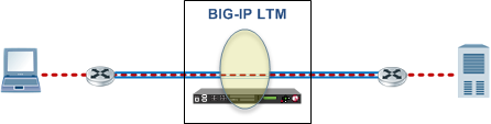

You can create transparent tunnels when you want to inspect and/or manipulate encapsulated traffic that is flowing through a BIG-IP® system. The BIG-IP system terminates the tunnel, while presenting the illusion that the traffic flows through the device unchanged. In this case, the BIG-IP device appears as if it were an intermediate router that simply routes IP traffic through the device.
The transparent tunnel feature enables redirection of traffic based on policies. For example, service providers can redirect traffic with transparent tunnels to apply classification and bandwidth management policies using Policy Enforcement Manager™. To handle payload inspection and manipulation, you can create a policy in the form of a virtual server that accepts encapsulated packets. In the absence of a policy, the tunnel simply traverses the BIG-IP device.
Transparent tunnels are available for IPIP and GRE encapsulation types, with only one level of encapsulation.
Illustration of a transparent tunnel
When the BIG-IP system receives an encapsulated packet from a transparent tunnel, the system decapsulates the packet, and re-injects it into the IP stack, where a virtual server can pick up the packet to apply a policy or rule. After applying the policy or rule, the BIG-IP can re-encapsulate the packet and route it, as if the packet had transited the BIG-IP unperturbed.
You can create transparent tunnels to inspect and modify tunneled traffic flowing through a BIG-IP system.
  3. From the Profile list, select ipip or gre.
    The ipip selection can also be one of the IPIP variations: ip4ip4, ip4ip6, ip6ip4, or ip6ip6.
  4. In the Local Address field, type 0.0.0.0 for an IPv4 network or :: for an IPv6 network.
  6. Select the Transparent check box.
  7. Click Finished.
Traffic flowing through the transparent tunnel you created is available for inspection and modification, before continuing to its destination.
