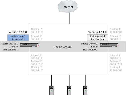

  • Devices run different software versions during migration, preventing normal config sync functionality until migration completes.
  1. Prepare each source device in the device group.
  2. Create and save an archive for each device.
  3. Download an archive file for each device.
  4. Force source device 1 offline, and observe that source device 2 becomes active.

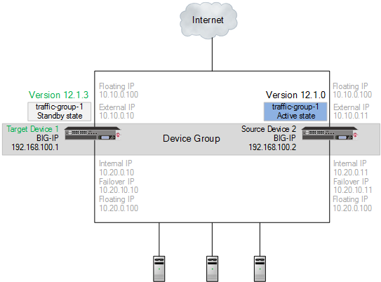

Migrated target device 1 in a device group
  1. Force source device 2 offline, and observe that target device 1 becomes active.

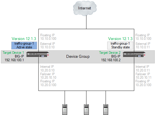

Migrated target device 1 and target device 2 in a device group
