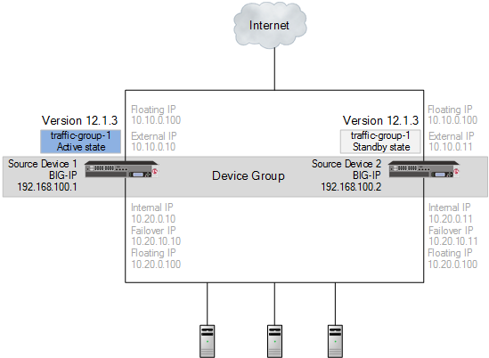

Device migration enables you to replace the devices in a BIG-IP device group running software version 12.1.3, or later, with newer devices running the same software version. It enables you to take an existing configuration on a device group’s source device and easily replicate it on a target device.
Source devices in a device group
Supported source and target platforms include appliances, VIPRION® platforms, virtual edition (VE) devices, and vCMP® guests.

When you migrate the source devices in a device group running BIG-IP software version 12.1.3, or later, to new target devices running the same BIG-IP software version, the following sequence of steps applies. This sequence migrates a device group composed of source devices 1 and 2 to a device group composed of new target devices 1 and 2.
Important:
  • For a device group, migration functionality reestablishes the device group with the target devices when you load an archive onto the second target device.
  • During migration, do not make any additional configuration changes. Reconfiguration during migration can cause unexpected behavior.
  • Devices run different software versions during migration, preventing normal config sync functionality until migration completes.
  1. Prepare each source device in the device group.
  2. Create and save an archive for each device.
  3. Download an archive file for each device.
  4. Force source device 1 offline, and observe that source device 2 becomes active.
  5. Shut down source device 1.
  6. Install target device 1.
  7. Prepare target device 1.
  8. Upload the source device 1 archive, and load the archive onto the target device 1.

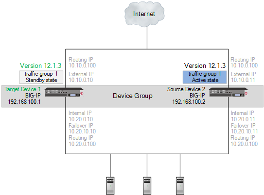

Migrated target device 1 in a device group
  1. Force source device 2 offline, and observe that target device 1 becomes active.
  2. Shut down source device 2.

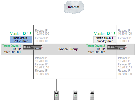

  3. Install target device 2.
  4. Prepare target device 2.
  5. Upload the source device 2 archive, and load the archive onto the target device 2, reestablishing the device group.
Migrated target device 1 and target device 2 in a device group
