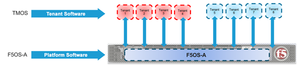

F5 rSeries systems include a platform layer that runs F5OS-A software, on which you can have multiple tenants. A tenant is a guest system running software (for example, a BIG-IP system). F5 r5000/r10000 platforms can run a minimum of one tenant up to 36 tenants. F5 r2000/r4000 platforms can run only one tenant on the low end and up to four tenants on the higher end. F5 r12000 platforms can run up to 60 tenants depending on the platform.
This illustration shows a simplified rSeries deployment. The rSeries system shown here has four tenants attached. In this example, you can have up to eight tenants running at one time.
