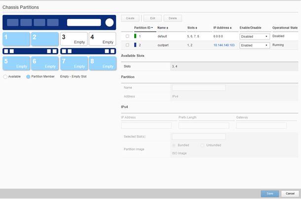

You can view details on how the chassis partitions are configured on your VELOS system.
  1. Log in to the system controller webUI using an account with admin access.
  2. On the left, click CHASSIS PARTITIONS.
    The Chassis Partitions screen opens.
  3. Review the partition data.
    • Examine the graphic to see how many slots are in use. Those in use are highlighted.
    • Look at the partition list to see how many chassis partitions currently exist, which slots are associated with each partition, the management IP address of each, whether the partition is Enabled or Disabled, and the operational status.
  4. Perform other tasks as needed regarding chassis partition management.
    • From here, you can create, edit, or delete chassis partitions.
    • You can Enable or Disable a partition using the dropdown in the chassis partition list.
Here is a sample Chassis Partitions screen with two chassis partitions, custpart, which uses the 2 slots that contain blades, and the other, default, assigned 4 empty slots. The custpart partition is Enabled and running.
