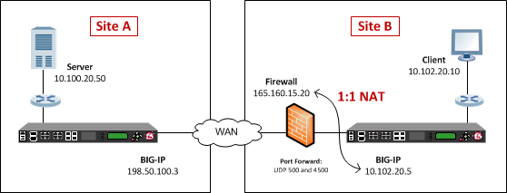

When you are using IPsec to secure WAN traffic, you can set up an IPsec tunnel with NAT traversal (NAT-T) to get around a firewall or other NAT device. This implementation describes how to set up the IPsec tunnel when you have a NAT device on one side of the tunnel.
The following illustration shows a network configuration with a firewall (NAT device) on one side of the WAN.
Example of an IPsec deployment with NAT-T on one side of the WAN

      If the remote BIG-IP system is behind a firewall or other NAT device, type the public IP address of that device.
      If the remote BIG-IP system is reachable directly, type the IP address of the BIG-IP system.
      Note: This address must match the value of the Tunnel Remote Address of the remote site setting in the relevant IPsec policy.
      For example, on Site A, you specify the translation address for the BIG-IP system in Site B. The BIG-IP system in Site B is behind the NAT device. Here are the peer remote addresses that you would configure on the BIG-IP systems in Site A and Site B, according to the previous illustration.
      Location Remote (Peer) Address
      Site A 165.160.15.20
      Site B 198.50.100.3
      This screen snippet shows the peer Remote Address setting at Site A.
      Screen showing Site A Remote Address setting

    6. In the Tunnel Local Address field, type the local IP address of the system you are configuring.
      For example, the tunnel local addresses that you configure on the BIG-IP systems in Site A and Site B are as follows.
      Location Tunnel Local Address
      Site A 198.50.100.3
      Site B 10.102.20.5
    7. In the Tunnel Remote Address field, type the IP address of the remote peer.
      If the remote BIG-IP system is behind a NAT device, type the public IP address of that device.
      If the remote BIG-IP system is reachable directly, type the IP address of the remote BIG-IP system.
      Note: This address must match the value of the Remote Address setting in the relevant IKE peer.
      Based on the sample configuration in the implementation overview, the tunnel remote addresses that you configure on the BIG-IP systems in Site A and Site B are as follows.
      Location Tunnel Remote Address
      Site B 198.50.100.3
      This screen snippet shows the tunnel settings at Site A.
      Example of tunnel settings at Site A

    5. For the Source IP Address setting, in the Address field, type the IP address from which the application traffic originates.
      In the illustration the source IP addresses that you configure on the BIG-IP systems in Site A and Site B are as follows.
      Location Source IP Address
      Site A 10.100.20.50
      Site B 10.102.20.10
    6. For the Destination IP Address setting, in the Address field, type the final IP address for which the application traffic is destined.
      In the illustration, the destination IP addresses that you configure on the BIG-IP systems in Site A and Site B are as follows.
      Location Destination IP Address
      Site A 10.102.20.10
      Site B 10.100.20.50
    7. For the Action setting, retain the default value, Protect.
    8. From the IPsec Policy Name list, select the name of the custom IPsec policy that you just created.
      This screen snippet is an example of the completed Traffic Selector screen at Site A.
      Example of completed Traffic Selector screen
    9. Click Finished.
