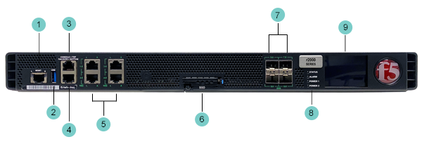

  1. 1000-BaseT management port
  2. USB 3.0 port
  3. Serial console port
  4. Serial failover port *
  5. 10G/1G RJ45 ports (4)
  6. M.2 SSD assembly (removable)
  7. 25G/10G/1G SFP+/SFP28/SFP ports (4)
  8. Indicator LEDs
  9. 2.2 inch LCD touchscreen

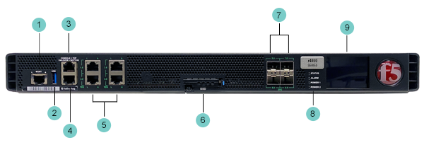

  1. 1000-BaseT capable management port
  2. USB 3.0 port
  8. Indicator LEDs

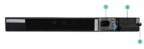

The back of the r2000/r4000 Series platform includes one power supply unit (PSU), one power blank, and a chassis ground terminal.
  1. Power input panel 1 (AC power receptacle)
  2. Power blank
  3. Chassis ground terminal

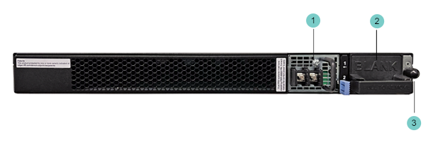

  1. Power input panel 1 (DC power receptacle)
  2. Power blank

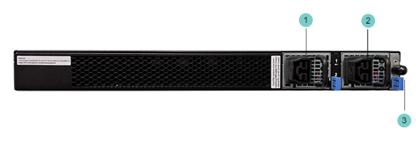

  1. Power input panel 1 (HVDC power receptacle)
  2. Power input panel 2 (HVDC power receptacle)
