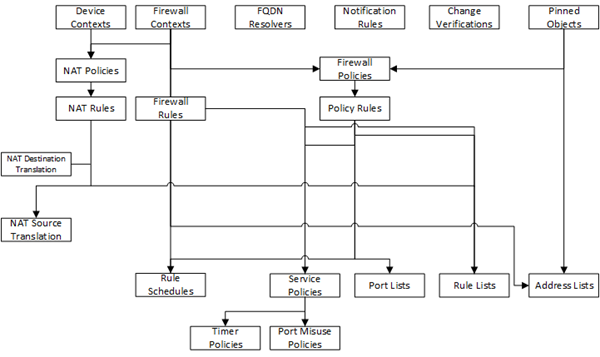

The objects that you manage using BIG-IQ depend on associations with other, supporting objects. These supporting objects are called shared objects because they are shared between multiple BIG-IP devices. When BIG-IQ evaluates a deployment to a managed device, it starts by deploying the device-specific objects. Then it examines the managed device to compile a list of the objects that are needed by other objects on that device. Then (based on the recent analysis) BIG-IQ deletes any shared objects that exist on the managed device but are not used. So, if there are objects on a managed device that are not being used, the next time you deploy changes to that device, BIG-IQ deletes the unused objects.
To change the object settings on a managed device, there are four tasks to perform.
This figure illustrates the workflow for managing the objects on BIG-IP devices. Evaluating the changes you have made is the third step in this process.

If you want to evaluate changes only to the selected objects, for Supporting Objects, clear the Include check box. It is almost always best to evaluate changes to the associated objects, as well.
Important: The objects that you manage using BIG-IQ depend on associations with other, supporting objects. These object associations form relationship trees that are sometimes quite complex. Generally, when you deploy a change to a managed object, it is a very good idea to include these supporting objects in the deployment. This diagram illustrates a typical relationship tree for a Network Services managed object. For Local Traffic objects, the trees are equally complex and just as vital to include.
