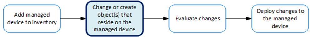

The workflows for creating a new object, or for changing the settings for objects that already reside on a managed device, are very similar. In each case, there are four tasks to perform.
This figure illustrates the workflow to manage the objects on BIG-IP devices. Changing the settings or creating the object is the second step in this process.
Change managed object workflow
